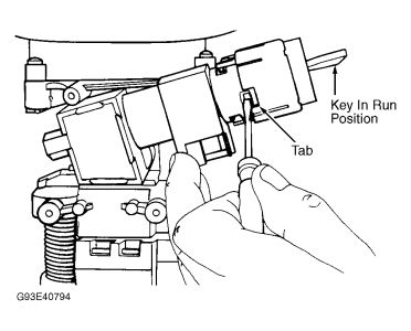

I turn my key and it turns, but when it hits the part of starting my car, its stuck. How would I fix that. I had to jump my started just to get my car started.

Insert key rotate to run align shaft at end of lock cylinder with socket in housing insert tab rotate off remove cylinder
https://images.2carpros.com/forum/automotive_pictures/99387_Graphic1_145.jpg
