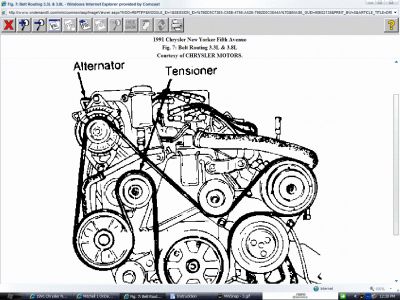

I am trying to replace Serpentine Belt in my car.
As you know I need to loose something to relief tense I don't know which part I need to loose to install belt.
Please help me.
thanks.
Feb 25, 2008 at 11:24 AM
MERLIN2021
  • 17,250 POSTS

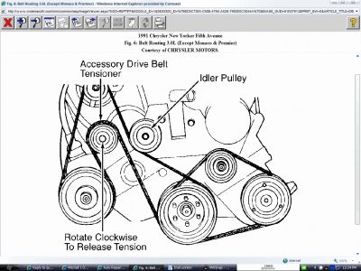

Use a box end wrench rotate the tensioner clockwise while holding remove the belt
https://images.2carpros.com/forum/automotive_pictures/62217_3_3.jpg
https://images.2carpros.com/forum/automotive_pictures/62217_33_2.jpg
Bottom pic is 3.0 top is 3.3 and 3.8
