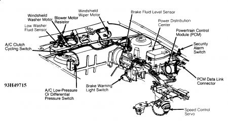

as bad as it sounds i cant find the blower moter on my car i have looked behind the glove box on the fire wall it is well hidden or i am blind could realy use a hand thanks joshua

It is at the lower right side of dash panel.
If I may ask why are you replacing or looking for the Blower motor?

was looking to replace it and have pulled the lower cover and have pulled the glove box to try and find it is it behind a gard or something because i have not seen any thing that resembles a motor and its not the first i have ever replaced its just a first for this car

Unfortunately I cannot find a pic or diagram to help with exact location. I was asking about why you were replacing it because there is a Blower Moter Resistor located under the hood behind the wash fluid that could be the culprit.
https://images.2carpros.com/forum/automotive_pictures/188069_91newyorkerlowerresistr_2.jpg

thanks will go ahead and check the resistor and thankyou for your help
