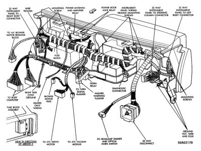

1989 Chrysler New Yorker heater blower motor resister
JAMES M KREUSCHER SR
Heater problem
1989 Chrysler New Yorker 6 cyl Front Wheel Drive Automatic
where is it located. its not behind the windshield washer bottle like the chrysler dealer told me
Jun 30, 2010 at 8:54 AM
BLUELIGHTNIN6
  • 16,542 POSTS
blower resistor block should be behind the right dash panel, pictured below..
https://images.2carpros.com/forum/automotive_pictures/261618_Noname_2401.jpg
