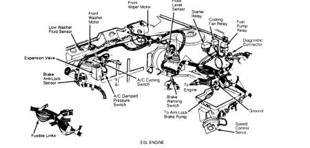

1988 Chrysler New Yorker 6 cyl
I have a 1988 New Yorker. It has been sitting for a few years. No fuel pump sound when key turned on. Where is the fuse or relay located?
Oct 4, 2010 at 6:47 AM
JDL
  • 16,098 POSTS
The fuel pump relay should be located under the hood on the driver side. Any applicable trouble codes? Sometimes when a vehicle sits that long, them little gremlins start chewing on the wiring, somewhere. The battery is ok?
