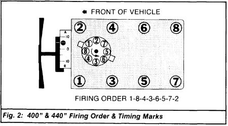

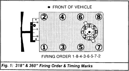

Please tell me the fireing order of this car

Same for all V8's Distributor is a bit different on 400-440 as shown below:
https://images.2carpros.com/forum/automotive_pictures/62217_400440_1.jpg
