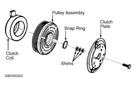

how do i remove and install a new clutch

The pic below may not be exact but all are similar as far as taking apart.... There may be a snap ring holding the clutch coil on.
