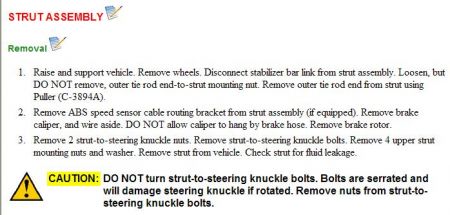

What is the fastest way to remove the front passenger strut?
