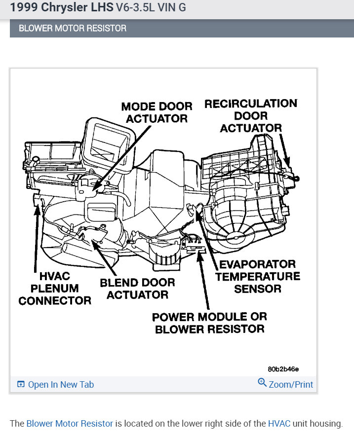

Has anyone had experience replacing a blower motor in a 1999 LHS...I'm unable to find any detail concerning this replacement...it is supposed to take about 2 hours and there is only seven steps per alldata...so I know there's a lot of detail in those steps...thanks john

Here is the location of the blower resistor in the diagrams below. Check out the diagrams (Below). Please let us know if you need anything else to get the problem fixed.

blower motor resistor

right of blower motor in air plenum is AC auto air?
