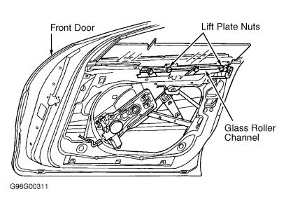

1999 Chrysler LHS left front window
1999 CHRYSLER LHS
103,000 MILES • 6 CYL • FWD • AUTOMATIC
HI2

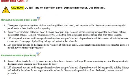

window is rocking & have to pull back by hand when closing. how do i rectify this & where can i find a free diagram of the window setup online?
Aug 4, 2010 at 9:17 AM
BLUELIGHTNIN6
  • 16,542 POSTS
you will have to remove door panel to visually inspect what is going on with the window.
https://images.2carpros.com/forum/automotive_pictures/261618_Noname_2542.jpg
https://images.2carpros.com/forum/automotive_pictures/261618_Graphic_628.jpg
