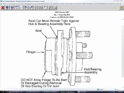

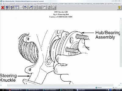

What is the procedure for replacing the right front wheel bearing assy?

Remove the axle nut, caliper and rotor, this will expose the bearong and hub, rotate the flange so the hole aligns with bolt heads and remove the bolts, pull bearing from hub...Torque axle nut to 110-130 ft lbs, and mounting bolts to 80 ft lbs

Thank you for your helpful reply. When removing the caliper and rotor do you need to disconnect the brake fluid line?
Reply: No! Just hang with some wire from the spring...
