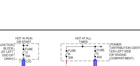

Engine Cooling problem
1999 Chrysler LHS 6 cyl Automatic
My fan stopped working and I went and bought a new one and put it in and it doesn't work either. What else could it be if the fan isn't working but the fan is good? Where do I look and where do I start?
Friday, February 27th, 2009 AT 5:18 PM
  • 75,992 POSTS
If you're talking about the cooling fan-check the fuses below/ high and low speed relay/coolant temperature sensor/engine temperature gauge/switch and also the computer controlled of the relays circuit.
https://www.2carpros.com/forum/automotive_pictures/12900_fuses_7.jpg
https://www.2carpros.com/forum/automotive_pictures/12900_circuit_2.jpg
