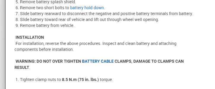

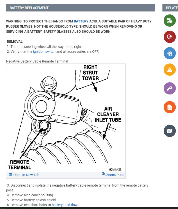

how do you replace the battery ?
Jan 3, 2009 at 4:19 PM
The battery on this vehicle is under the air cleaner housing in the fender and once you remove the air cleaner housing you will see it.
There is a remote negative terminal that if you follow down you will see the battery location.
Here is a guide that helps with this:
https://www.2carpros.com/articles/how-to-replace-a-car-battery
Below you will find the info from the manual that will give the remaining details needed to perform this.
Please let us know what other questions you have. Thanks
