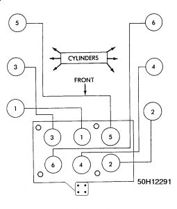

Electrical problem
1996 Chrysler LHS 6 cyl Front Wheel Drive Automatic
I need a diagram of the firing order from the plugs to the coil in cylinder order.

https://images.2carpros.com/forum/automotive_pictures/99387_Graphic1_329.jpg
