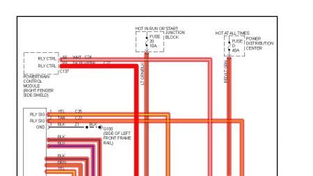

1996 Chrysler LHS 6 cyl Two Wheel Drive Automatic
the fans just works when i turn on the a/c, i replaced the thermostat, the coolant temperature sensor, radiator cap, i tested the relays & looks to be ok.
Jul 23, 2008 at 8:26 AM
  • 75,988 POSTS

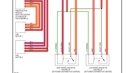

Could be fuses, computer relay control or the radiator fan module-see below
https://images.2carpros.com/forum/automotive_pictures/12900_fr1_2.jpg
https://images.2carpros.com/forum/automotive_pictures/12900_fr2_1.jpg
