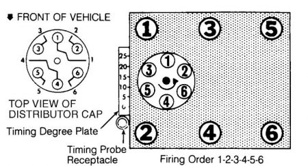

I need the firing order for these cylinders.

https://images.2carpros.com/forum/automotive_pictures/261618_Noname_331.jpg
