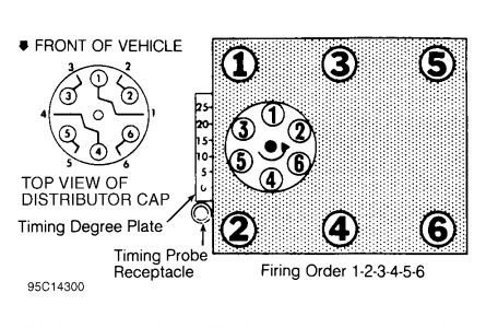

1995 Chrysler Le Baron 6 cyl Automatic
What is the firing order?

https://images.2carpros.com/forum/automotive_pictures/261618_Graphic_553.jpg
