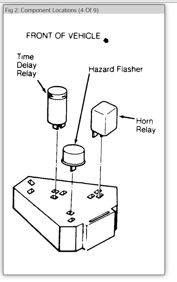

Need to know the location for the turn signal/hazard flasher - not in fuse block or under dash. What other locations could this be found?

Hey DENNIS69
Behind left side of dash, mounted on left air outlet duct. It is the time delay relay.
