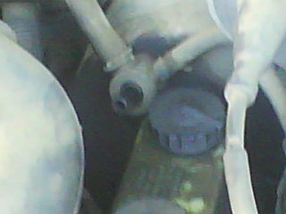

1993 Chrysler Le Baron vacuum leak
MANNINGB57
1993 Chrysler Le Baron 6 cyl Two Wheel Drive Automatic
On the power brake booster, there are three hoses coming from the vacuum outlet. the one that comes straight off the front is disconnected and I cannot find where it connects to. I have checked my haynes guide and it does not give me the answers that I need. Would you be able to tell me where this crazy hose goes so that I can get the car smogged?[img:524323f5b9]http://www.2carpros.com/forum/automotive_pictures/402492_DSC00022_1.jpg[/img:524323f5b9]

Hi there,
Thank you for the donation,
I will try and look this up for you on Mitchell, but the vacuum line charts are very basic at best, if there is no loose vac hose and no other port open, this may be a spare vac port not used and it can be capped with a rubber vacuum plug.
mark (mhpautos)
