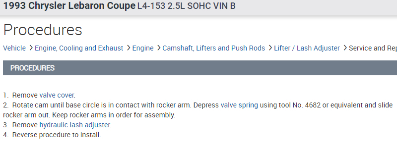

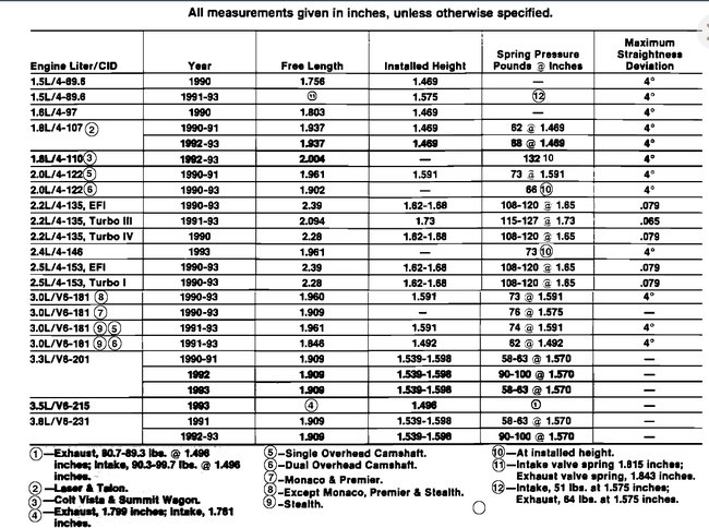

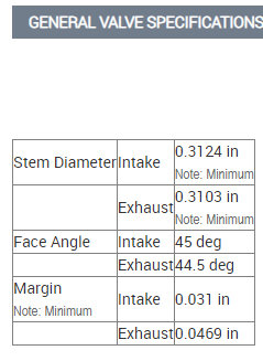

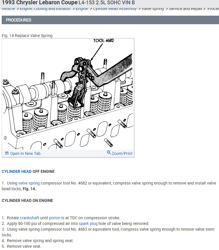

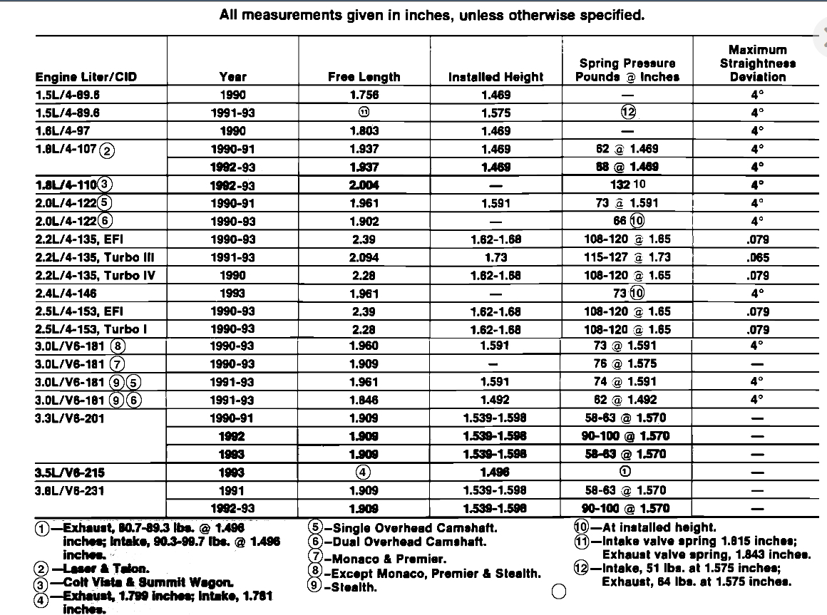

How do I adjust the valves?
1993 CHRYSLER LE BARON
MUZZCAT1
MEMBER
1 POST

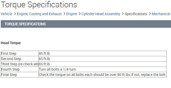

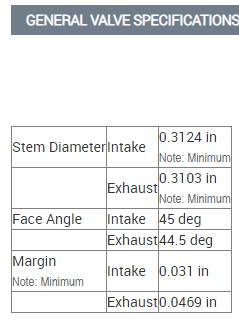

How can I tighten and what's the torque?
Sep 4, 2009 at 10:56 AM
SQM
Experienced Mechanic
6,383 POSTS
Please see attached for torque specifications and few more helpful info. Check out the diagrams (Below). Let us know what happens and please upload pictures or videos of the problem. Let me know if you have any questions.
