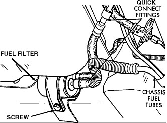

were are the fuel filters located? and how do u take them off?

Fuel Filter Location

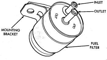

Fuel Filter

WARNING: The fuel system is under constant pressure, even when the engine is OFF. Always release fuel pressure before servicing any fuel system component. REMOVAL Release fuel system pressure. Disconnect the negative battery cable Raise, and support the vehicle for access. Loosen fuel filter hose clamps and remove the fuel hoses from the inlet and outlet fuel filter nipples. Remove the mounting bracket bolt, and remove the filter. INSTALLATION Install the new filter assembly on the mounting plate. Be sure the direction of flow matches the markings on the filter. Install the mounting bolt, and torque to 8 Nm (75 in-lbs) Install the inlet and outlet hoses, and tighten clamps to 1 Nm (10 in-lbs). Lower the vehicle, and connect the negative battery cable. Using scan tool [1] , activate fuel pump and pressurize system. Check for leaks. Remarks [1] Follow scan tool manufacturer's instructions. https://www.2carpros.com/kpages/auto_repair_manuals_alldata.htm
