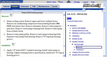

I bought a water pump for my 1988 chrysler lebaron because it has been leaking coolant. I am trying to fix this on my own but it seems hard to get to the water pump to take it out. On this car how to I get to the water pump.... do I need to take anything else off before hand in order to get to the water pump?

See below
https://images.2carpros.com/forum/automotive_pictures/12900_22_1.jpg
