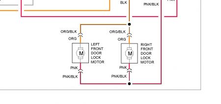

Hello.
Do you know were are located the power door relay on a 1988 Chrysler Lebaron 2.2L turbo coupe ?
Jun 8, 2009 at 5:08 PM
  • 75,992 POSTS

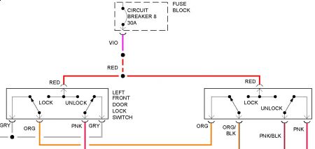

C/B no.8 30amp powers the door lock system Its in the fuse block called circuit breaker check no.8 30amp breaker.

Hello.
Thank you for your quick answer.
You are talking about the fuse in the fuse box, but not the relay who are not in the fuse box at the right place under the steering wheel column.
Thank you also for the diagram, but it's too small and i can't read it.
Would you please check again for the place of the power door lock relay place.

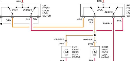

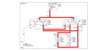

  • 75,992 POSTS
I've checked for the relay but there's non listing for your vehicle only the circuit breaker
https://images.2carpros.com/forum/automotive_pictures/12900_dl1_1.jpg
https://images.2carpros.com/forum/automotive_pictures/12900_dl2_1.jpg
https://images.2carpros.com/forum/automotive_pictures/12900_dl3_1.jpg
Jun 9, 2009 at 1:03 AM
LIONELCGZ
  • 25 POSTS
Thank you for that. That helps me a lot.
You are right, there are no relay. The switch are the relay.
