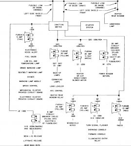

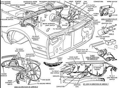

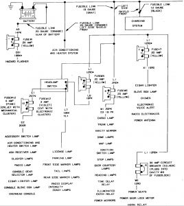

It seems that the AC compressor is on the same fusible link.
https://images.2carpros.com/forum/automotive_pictures/521573_42228795_1.jpg
https://images.2carpros.com/forum/automotive_pictures/521573_42228794_1.jpg
https://images.2carpros.com/forum/automotive_pictures/521573_42272945_1.jpg
Apr 27, 2010 at 6:52 AM
CARADIODOC
  • 34,381 POSTS
Dandy. You can get away with unplugging the fan if you use the AC at highway speed. If the fuse still blows, I would look closely at the wiring near the compressor clutch first. The magnetic coil could be shorted too, but intermittent problems are more likely to be caused by rubbed-through wires than the coil itself.

Nope. Unless I'm missing something, the two should be independent of each other. The only exception would be if the Engine Computer detects the open circuit to the fan motor, but in that time period, it only detected an open circuit for the coil part of the relay, not the high-current side.
I had a similar situation with my '88 Grand Caravan. A former student mistakenly left the fan motor's ground wire off when replacing my starter. I didn't notice it for a couple of years because all of my driving was on the highway. What little I used the AC, it still worked fine.
Now, just so I'm clear, you're talking about unplugging just the fan motor, not removing the relay, right? Have you ever noticed if that fuse blows when you are NOT using the AC? I suspect it will not because both the fan and compressor are turned on with relays so any short should be out of the circuit if the AC isn't turned on. Also, since the system worked for 2 days with a 30 amp fuse, it suggests the compressor clutch does not have a dead short although it could be intermittent. I have a trick that can tell if that is the case, but it involves running a pair of wires into the passenger compartment and connecting a light bulb. It will tell you when a short occurs, but not exactly where. Also, it means driving without air conditioning.
If it becomes a constant dead short, my light bulb trick helps in locating it too.
