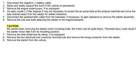

How do I put in a new starter?
May 19, 2010 at 9:17 AM
INTERNETMECHANIC
  • 700 POSTS
My info showed this procedure.
