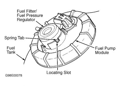

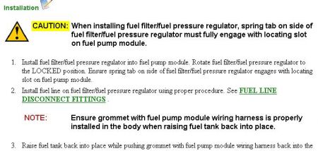

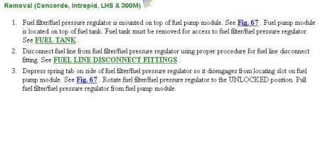

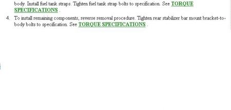

hi where is fuel filter chrysler interpid.
