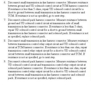

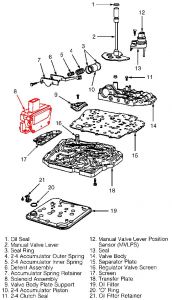

I'm getting a the above subject message from my car diagnostic tool that was used on my Intrepid. Where is the Solenoid located with regards to this error message I am receiving. Please get back to me asap!
Thanks
Greg
Feb 15, 2009 at 9:14 AM
ZACKMAN
  • 4,202 POSTS

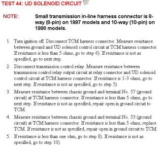

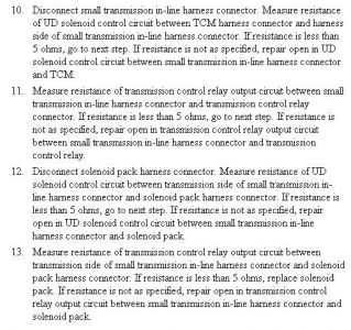

Diagnostic for P0765

https://images.2carpros.com/forum/automotive_pictures/55316_9842levalvebody_1.jpg
