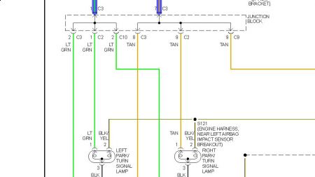

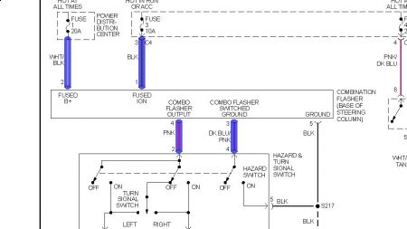

as stated in the subject my hazard and turn signal lights dont work, not even the indicators in the dash work. ive checked the bulbs, they seem fine, ive checked the fuses, theyre ok. i looked at the electronic flasher, and the prongs looked ok. there was some moisture in the bulb housing on the front drivers side, i took it out and checked it, some corrosion around the socket but nothing obstructing a connection, i checked the other side as well and it was a-ok. all the rear lights have been replaced and proven to work. the oinly thing i havnt done is use and ampre-meter and check the wiring. if i check the wiring and its ok, what elese could i have to look at, and if the wiring doesnt check out, what do i have to look at then? and also could it possibly still be the signal flasher even though the prongs look ok, no discolouration or appearance of charring?

Hi IIVIIetal, Welcome to 2carpros and TY for the donation Its a lot easier to replace the combo flasher then then the turn/hazard switch-I'll do the flasher 1st
https://images.2carpros.com/forum/automotive_pictures/12900_fl_2.jpg
https://images.2carpros.com/forum/automotive_pictures/12900_fl2_1.jpg
