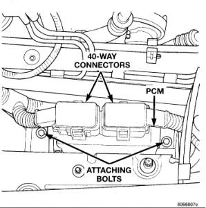

i need to know where my ecu is on my intrepid and if u have a picture to help me that would be great.

https://images.2carpros.com/forum/automotive_pictures/12900_pcm_31.jpg
The Powertrain Control Module (PCM) is mounted in the right front corner of engine compartment.
