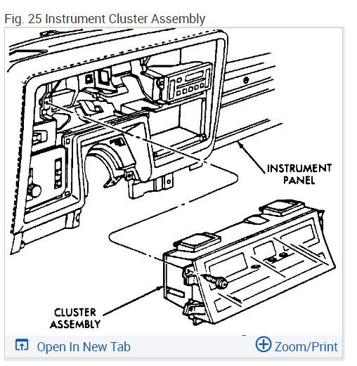

Friends, I have a problem with my Imperia 1992, suddenly turned off all indicators of the board of information, all is digital board, Temp, Fuel, Oil, Odometer, Volts. all digidash turned off,.
Wait for your answers.

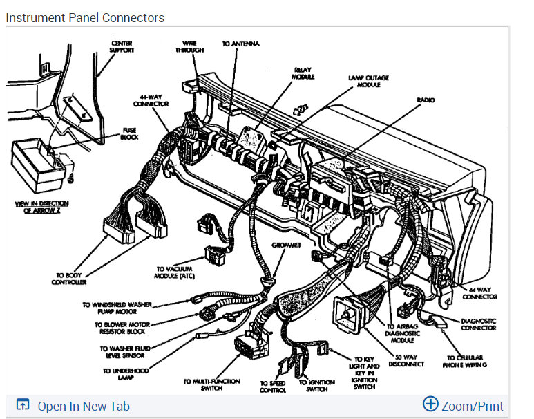

Try disconnecting the battery for about 10 minutes. See it that resets the BCM.

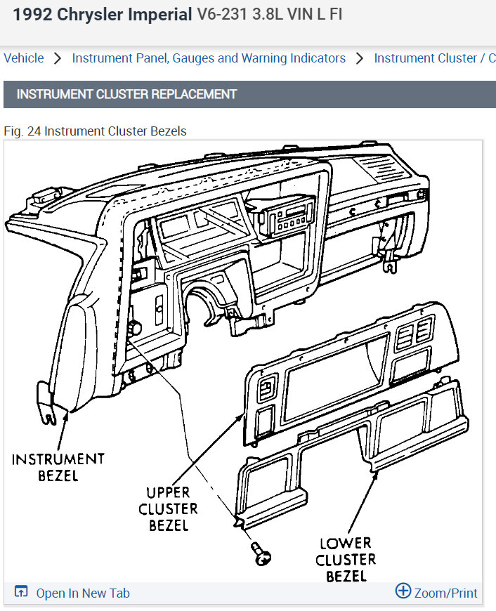

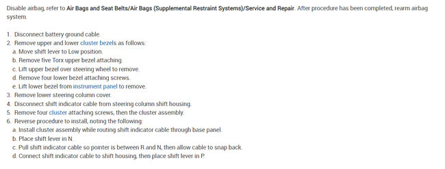

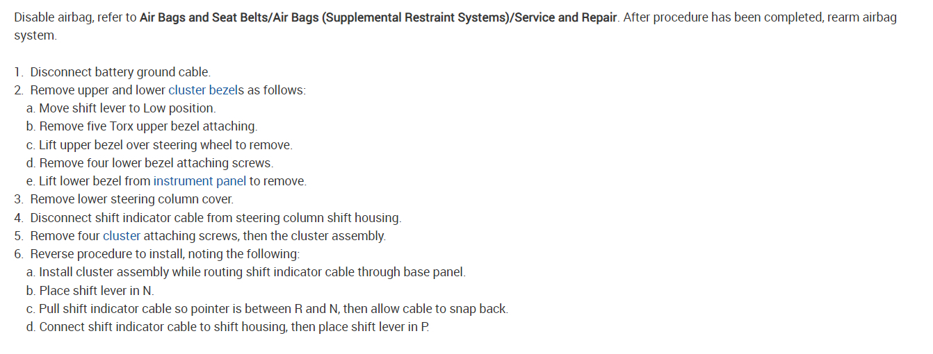

Also, I would start by checking the fuses, here is a guide to help and the fuse location below, if the fuses are okay I would swap out the instrument cluster.
