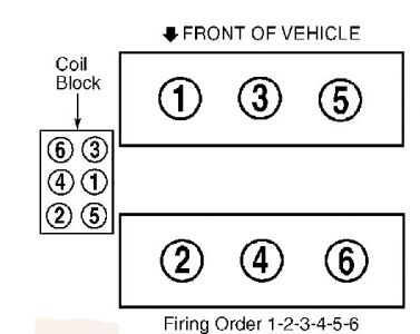

92 Voyager LE V6 3.3 Litre
I need to know the firing order to replace plugs and leads thankyou ...

https://images.2carpros.com/forum/automotive_pictures/30961_fir_1.jpg
https://images.2carpros.com/forum/automotive_pictures/30961_winksmily_5.jpg
