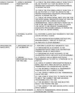

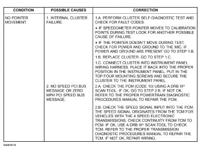

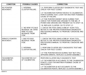

Can you tell me where the fuse or module is located
for these items so I can replace it or have it tested?
Neither one work. Everything else seems ok.
Battery wasn't getting power from battery. Had to
replace( plus + ) side of battery lead connector was
corroided. Now these gauges don't work.
Apr 29, 2010 at 2:07 PM
BLUELIGHTNIN6
  • 16,542 POSTS
https://images.2carpros.com/forum/automotive_pictures/261618_Graphic_474.jpg
https://images.2carpros.com/forum/automotive_pictures/261618_Graphic2_69.jpg
https://images.2carpros.com/forum/automotive_pictures/261618_Noname_2080.jpg
