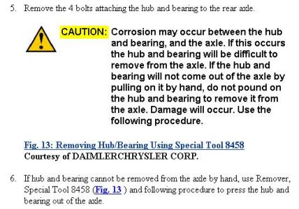

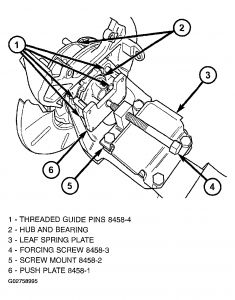

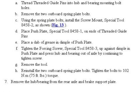

For the life of me, I cannot get the bearing off. I am using a slide hammer with and puller bolted to the hub. The 4 bolts are removed and I've used a can of PB Blaster. Nothing. It doesn't move. What am I messing. I've been banging on it for hours.

You may need to use this puller instead.
