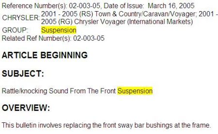

Hi, not positive about problem, but, found this bulletin. The bulletin goes on to say, noise most noticeable when you hit a bump.
https://images.2carpros.com/forum/automotive_pictures/170934_sway_bar_bushings_1.jpg
