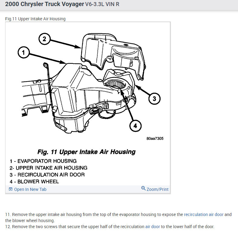

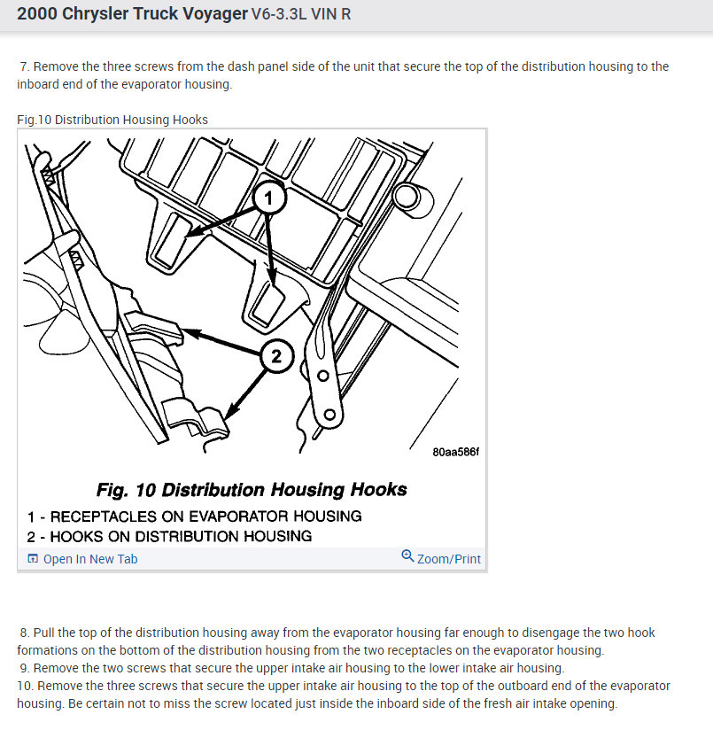

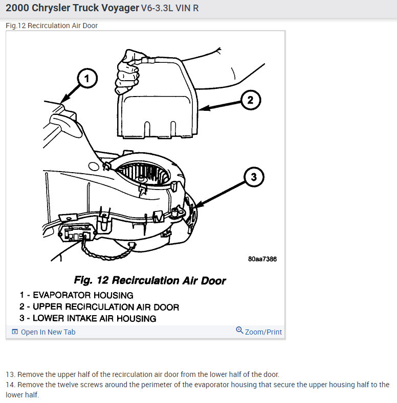

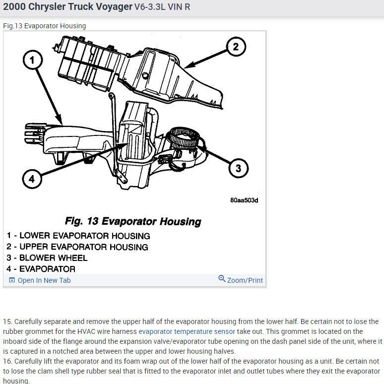

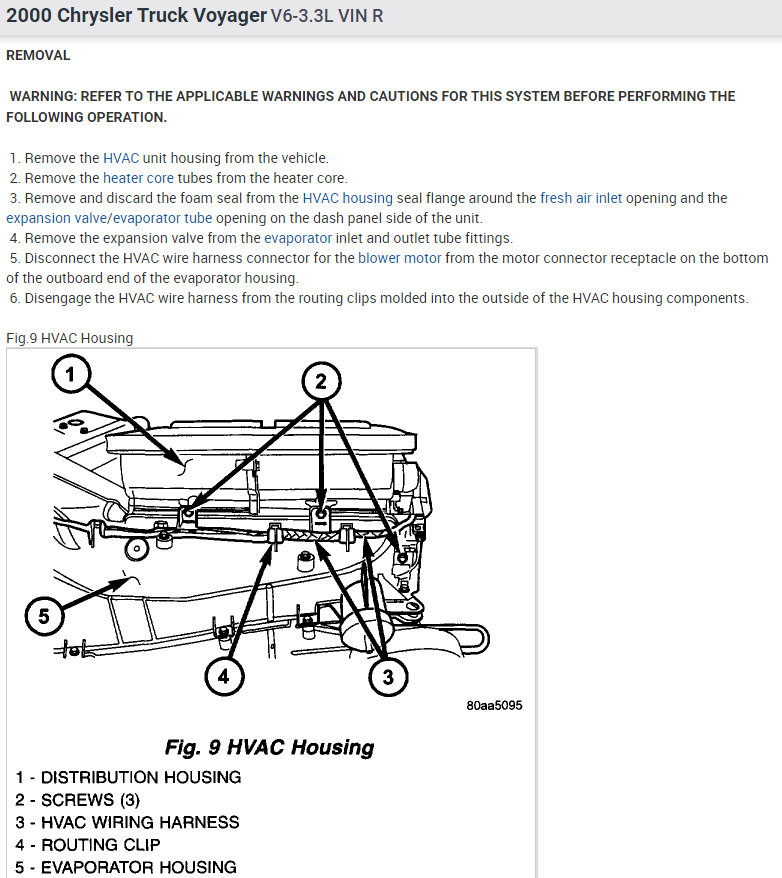

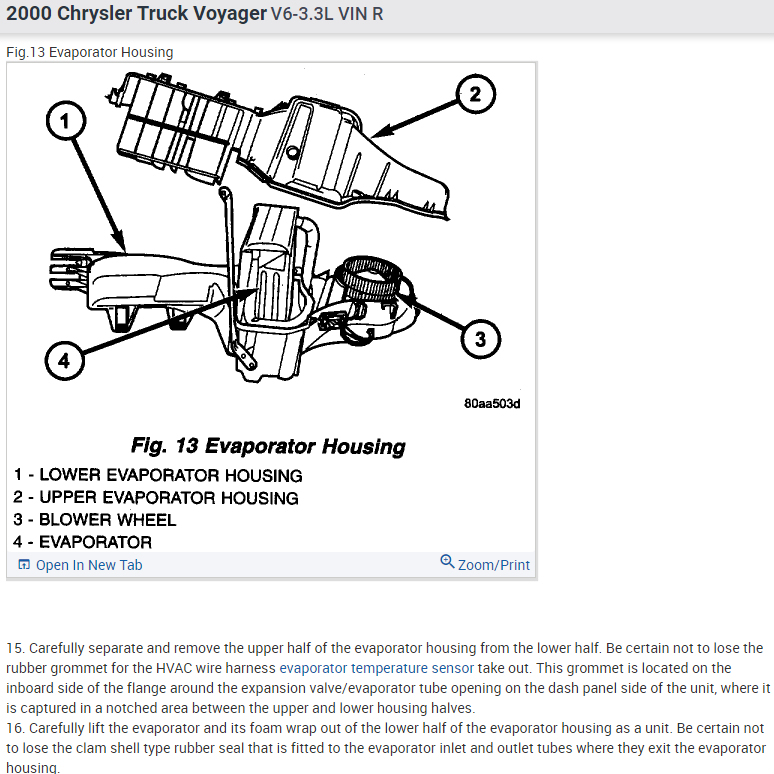

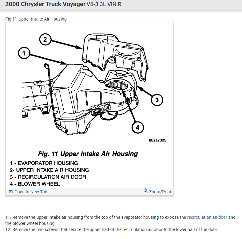

I need to replace the evaporator core Where is it? How do I replace it?
Jul 7, 2009 at 2:09 PM
SQM
  • 6,383 POSTS
The evaporator core is located inside the HVAC unit, which is located behind the dashboard on the passenger side.
First you will have to remove the lower dash panel to access the HVAC box. It can be done using simple hand tools.
I have attached the replacement diagrams for your reference.
