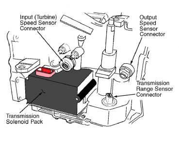

Most common is the tranny solenoid pack I would have it scanned for TCM codes
https://images.2carpros.com/forum/automotive_pictures/99387_caravan_tranny_19.jpg
