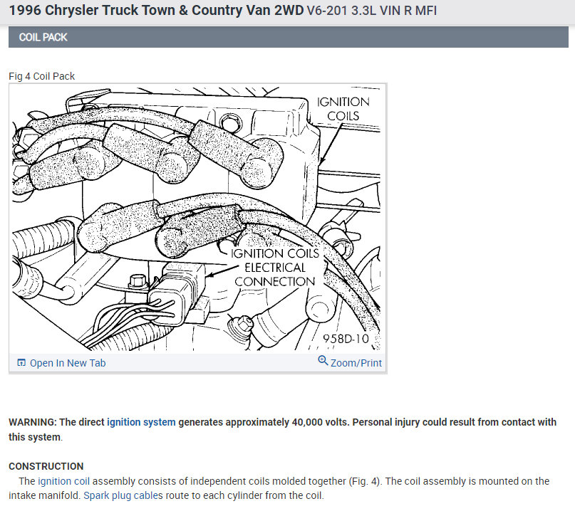

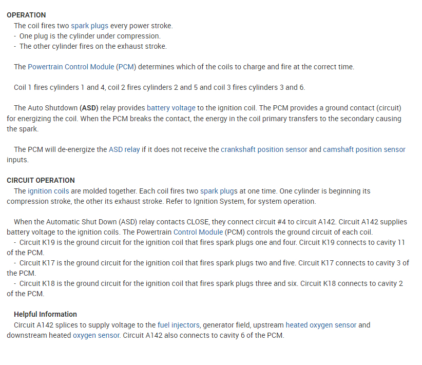

The van ran and just stalled there is no spark any suggestions?
Nov 9, 2008 at 11:20 PM
SQM
  • 6,383 POSTS

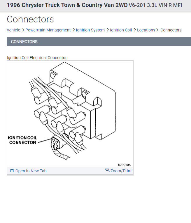

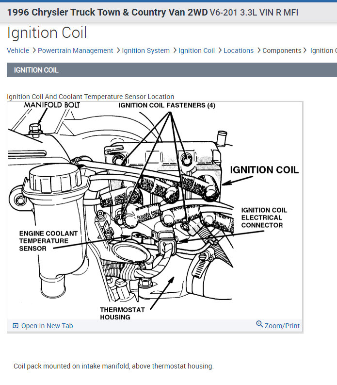

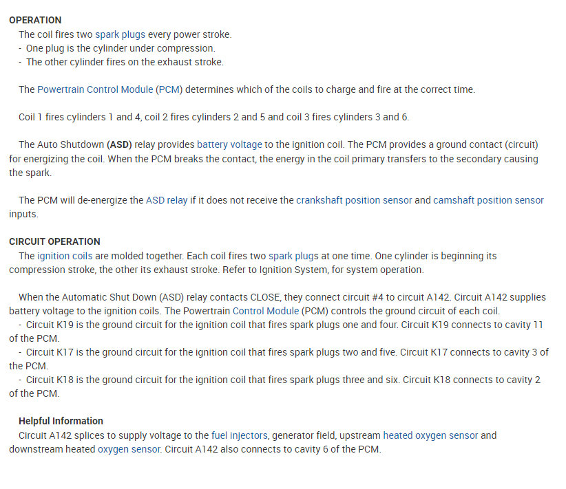

If you do not have spark to any of the spark plugs, it could be due to a faulty coil pack.
The coil pack is mounted n the intake manifold, just above the thermostat housing. It is where all the spark plug wires connects to. (see diagram)
Over time heat and vibration can cause a coil pack to fail. When that happens you will loose spark to the engine and the engine will not start.
