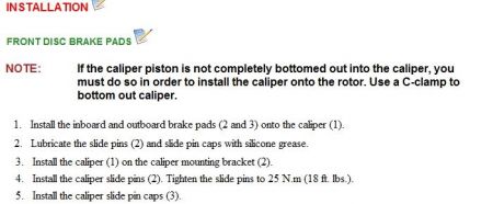

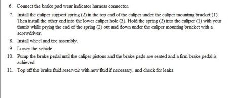

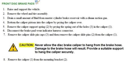

Can you please a give me the step by step procedure of replacing the front pads?
Friday, March 19th, 2010 AT 4:58 PM
BLUELIGHTNIN6
MECHANIC
16,542 POSTS
SPONSORED LINKS
Friday, March 19th, 2010 AT 6:26 PM
