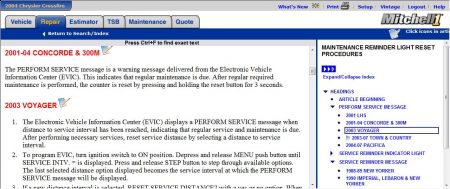

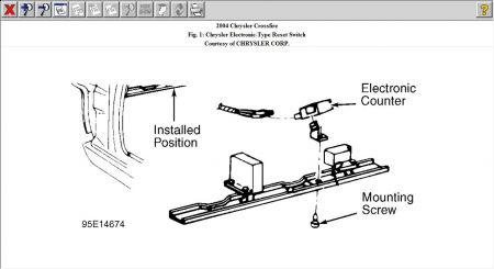

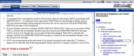

Sounds like you are dealing with the service maintenance reminder turn key to run and press the reset button for 3 secs. Unable to clear it you need to bring it in to the dealership.
