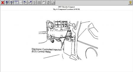

Car wouldn't start so thought it was the fuel pump but it seems that the fuel pump is not getting any power checked all fuses are fine. Is there a sending unit or relay that may have gone bad?

Your power comes from the control relay thru the black and white wire to the fuel pump

OK, thanks rasmataz for that information but could you please help me find this relay. There are several under the hood and I don't know how to tell which one it is. Can this relay be tested to see if it is bad when I find it?

There you go have a nice day Electronic Controlled Injection (ECI) Control RelayAbove ECU, on right side kick panel.
https://images.2carpros.com/forum/automotive_pictures/12900_control_relay_1.jpg
