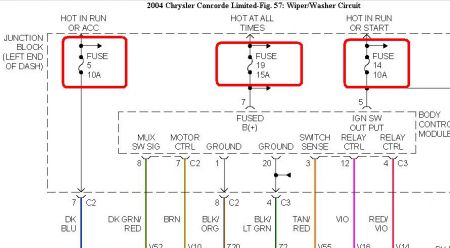

Wiper blades won't move- suspect fuse but the labels on the fuse block do not indicate which one is for the wipers. Also looked in the manual- no luck.
Can you help me to identify the proper fuse so I don't have to pull them all and inspect?

https://images.2carpros.com/forum/automotive_pictures/55316_04intrepidwiper_1.jpg
