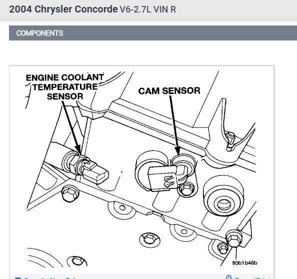

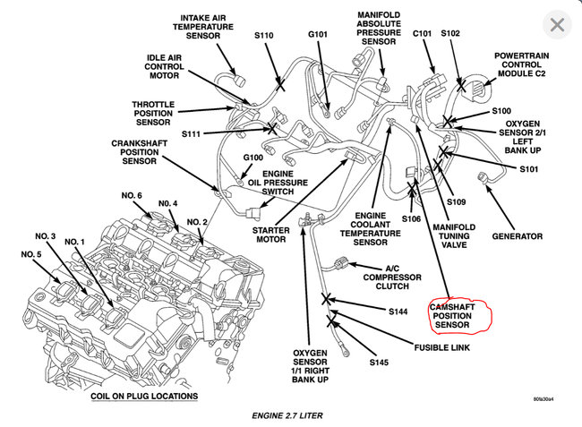

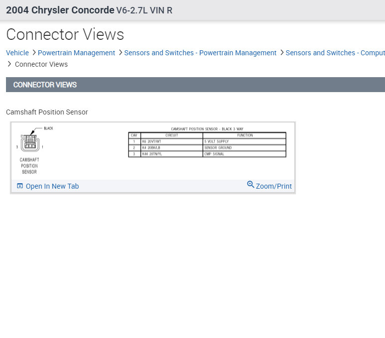

Replacing camshaft position sensor where is it located and how to change it?
Sep 6, 2009 at 7:32 AM
SQM
  • 6,383 POSTS

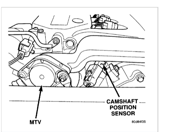

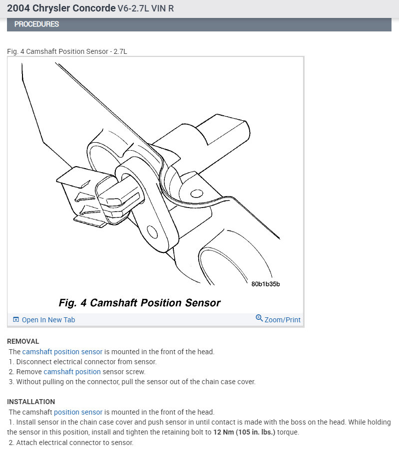

The cam position sensor is located front of the head on the driver side.
To remove the cam sensor, simply unplug the harness and remove the mounting bolt.
The sensor will pull straight out.
Here is a helpful guide:
https://www.2carpros.com/articles/camshaft-angle-sensor-replacement
