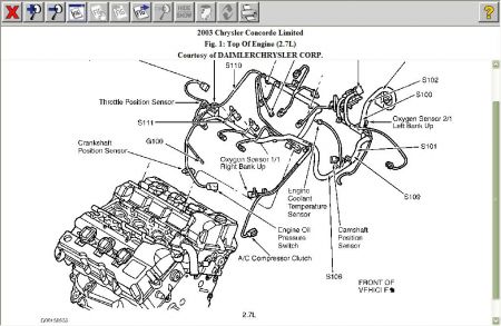

2003 Chrysler Concorde Code PO340
96,000 MILES • 6 CYL • 2WD • AUTOMATIC
NB BEAR
My wifes car developed this problem and the resulting code PO340. My question is ... how would a handy DIY kind of guy make repairs?
1- Where is the cam sensor located and is it something that I could replace in the garage.
This is the second one that has gone bad ... Last one cost $400.00+ to replace.
2- Could it be something else or any additional concerns I should look for.
Thank you so much for your time and consideration

2.7L
https://images.2carpros.com/forum/automotive_pictures/12900_cam27_1.jpg

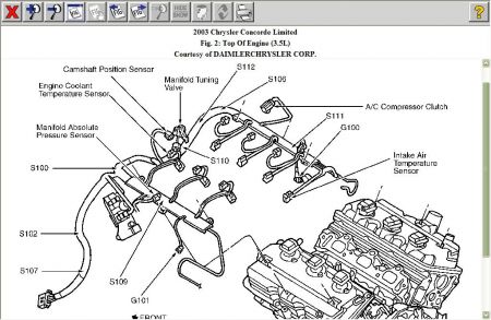

3.5L
https://images.2carpros.com/forum/automotive_pictures/12900_cam35_1.jpg
