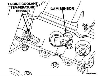

Help. My car needs a new camshaft position sensor. Seems like a pretty easy fix, but I can't find the sensor. Can you help me find it?

Hello There are numerous V6 engines for your vehicle. I choose a 2.7L. I this is not your engine then please tell me what it is and the 8th digit of your VIN.

It is a 3.5 Liter V6 and the 8th digit is "G"

Thanks for the info.....just so happens on this model it is in the same location.
