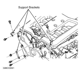

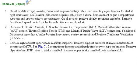

how do you change the water outlet. Do you have to take the plenum off. if so, is it difficult?
Feb 17, 2009 at 9:17 AM
ZACKMAN
Experienced Mechanic
4,202 POSTS
The entire upper intake manifold has to come out.
The water outlet goes all the way back towards the firewall and be replaced as one unit.
