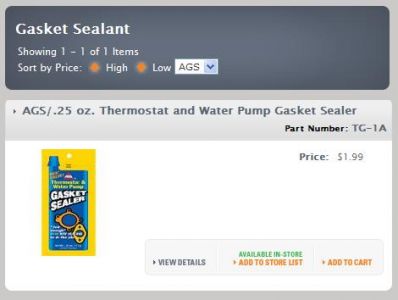

Thank you, but it is only the cover that is off and we can't seem to seal it again. When we put a sealant/gasket material it doesn't harden enough. Ie when we press the accelerator water still comes off and we can pull cover right off. What do you recommend to seal cover?
Thanks for your prompt reply, really appreciated!

Sorry about that. Are you letting the sealant set as described on the instructions of the product? The sealant I use for thermostats is just little pack of sealant made specifically for water pumps and thermostats. Most part stores have it.. a pic. of it is below found on the AutoZone.com website.
https://www.2carpros.com/forum/automotive_pictures/261618_Noname_500.jpg
Just follow the directions word for word and it works fine for me everytime I've used it..

Thank you very much! Will try that because it's only the cover that we can't seal. Would have to drill to put bolts to hold cover down. You just saved us time and money!
