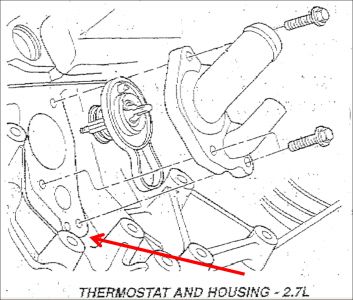

the bottle was full of cooliant it is leaking around the thermatac

Hello - I have attached a pic........was it leaking here at the base of the thermostat housing?
https://images.2carpros.com/forum/automotive_pictures/248015_Picture1_76.jpg
Is it still leaking? If so, have you checked the bolts to see if they are tight? Did this just start after the change of the bottle?
