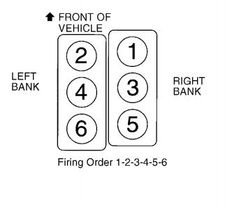

What is the firing order for the 2.7 engine

firing order goes like this
https://images.2carpros.com/forum/automotive_pictures/99387_27_concord_firing_order_2.jpg
