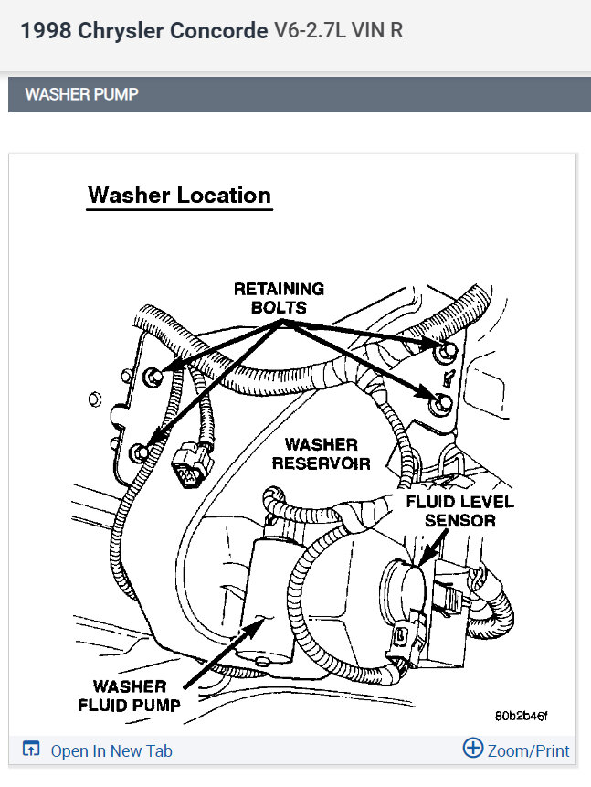

How do I get the windshield washer reservoir out of the car so I can replace the washer pump?

Not so simple to do. Disconnect neg battery cable, raise and support vehicle, remove front bumper,remove retaining nuts and screw to remove resevoir.

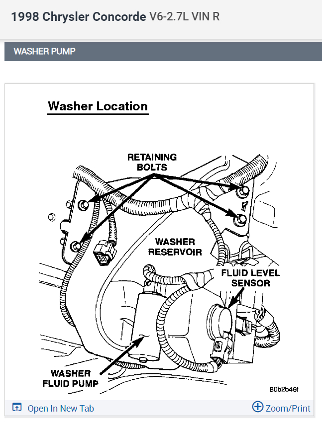

Here is the location of the washer pump and how to replace it. Check out the images (below). Let us know if you need anything else.
