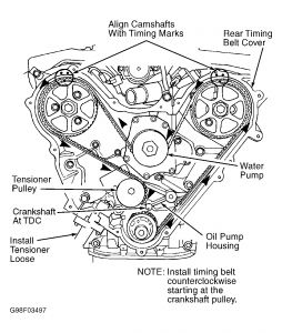

i need a diagram to help me set the timing chain

engine size????????? timing belt
https://images.2carpros.com/forum/automotive_pictures/99387_35_4.jpg
